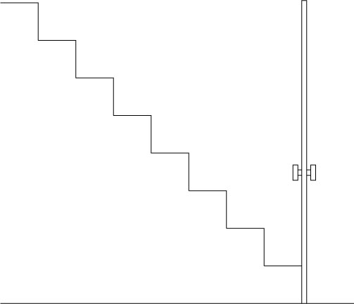

We just finished the construction on our hurricane damaged attic and I started thinking. After the hurricane we added the door back to the stairs that go up to the attic. But the stairs end (or begin) right on the other side of the door. In other words, you open the door and you immediately step up. Which is fine going up. Coming down is a different story. Coming down you are on the 2nd step up and have to reach way down to grab the handle. Which is normal height for the opposite side. But the stair side is super low. So I'm trying to come up with some kind of ingenius way to put a handle higher up that "feels" more normal on the stair side that will turn the normal handle and open the door. I've probably really cocked up that explanation.

Was it always that way?
I'd probably reinstall the door knob higher up, patch the hole in the door with one of those round plates for patching a door knob hole in a door, and make the corresponding necessary chisel/cut in the frame.
Unless you think little kids need attic access (they know it's haunted anyway, riiiight?) it shouldn't be a big deal to reach up at shoulder height for you to turn the knob when entering it.

I have that situation, too. Not a solution to move the knob, but perhaps if you install an ADA type handle (flat) then you can kludge a rope tie through an eyelet or similar to pull on.

I should have said I do NOT want to raise the door handle b/c I'd rather it be weird on the stair side vs the living side. Having a doorknob way up high on the hall side would be strange.
Ha. Thats kind of what I was thinking.

Or perhaps 2 dowels about a foot long. Dip one end of each about 3-4 inches into liquid rubber, drain and let dry. Lay the dowels parallel, wrap a few rubber bands around the undipped ends (cut notches to hold the bands if required). Spread the dowels apart to form an upside-down V, place the open, dipped ends around the door knob, and secure the dowels above and below the knob with more rubber bands. Positioned vertically, the dowels shouldn't cause the knob to turn unless sideways pressure is applied, and less than a 45 degree lean should turn the knob enough to open the door.
Or use mrbigstuff's idea and use your knee to push the lever down.
Dude! Embrace the weird. Or chop off the bottom stairs and make a landing for behind the door. Because if it’s appearance, not functionality, that bothers you, whoever next buys the place is gonna see the stairs were made wrong where they meet the door and consider that far more egregious than one oddball doorknob.
The door in question is going to be painted Tardis Blue and have Police Box stenciled on it. I'm not worried about weird.

Or maybe something in between. Can the bottom step get cut in half so that the half closest to the knob is more like a small landing.

Switch the door from a conventional door to a bifold door (center open) to match the British police box aesthetic. You can just push the doors open from the attic side.
The real question is -- is there another way into the attic? If not, aren't you going in via the door so it would be open? Or do you have to close it behind you to prevent someone from escaping?

put a second dummy doorknob on the inside up where you want it - just on the inside, mounted to the door, just one handle nothing else. Then fit a large, tight, loop connecting both knobs (think innertube rubber band). When you turn the top handle, it should turn both via friction.
You could do the same basic concept with a sprocket in place of the main knob, then a crank handle at the height you want, connect the two with a bike chain. Turn one, and the other works.

While these stairs go to an "attic". It is a finished attic. In that, it is drywalled, painted, and has a separate HVAC, but due to the ceiling height (and the not up to code stairs) cannot be considered "livable space". So it's conceivable that someone would go up there and stay for a period of time and close the door behind them.

Put a LEVER type handle on the stair side. Attach a cord, a rod (or whatever works) to said lever and have the other end go ah high as you need it. Then you can pull or push on the raised end and open the door.

Dummy door handle + Hydraulic door closer.
Just pull / push on the door to open. Closes behind you automatically.

Here's what I would install. Remove the existing handle and remove the latch portion. Reinstall the handles as before.
Now you need a closet door ball catch. The kind with the ball unit screwing into a mounting plate. On the jam you replace the jam plate with new one included in the set.
Fitting you might need glue and toothpicks. Then adjust the ball unit for that just perfect push on the attic handle for success.
You put a shower grab bar on the upside vertically to close from above. A 32" one goes for about $20. It should work as a push bar to open on the way down.

Replace the inside handle with a gear. Use a series of gears to a new handle higher up.
Edit: or use two gears and a belt or chain.

No door knob. Pull handle on the outside, kick plate on the step side. Kick the door open.

I like using a lever knob on the inside. It is now a toe-operated door.

Get one of those cylinders you see on screen doors to pull it closed. Don’t bother having a latch.

Can't remove any stairs or that first step would be a double step up...or down.

Move the door out three feet from the last step down which would create a small landing. Of course I don't know whether that's possible because I don't know where the current door is situated.
