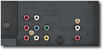

Here's the jack pack on the back of the TV;
...and there's another composite (S-video, and yellow, red + white, and 1/8" headphone jack) hookup behind a push button door panel on the front of the TV. It works fine, but is not being used-- though still retains the name "GAMECUBE" from Baby Buzz's youthfulness in 2005.
That's what I'm saying, the TV and cable box aren't syncing via the component connection, but there's no controls that I can find that allow user tweaking vis-a-vis the colors cables or refresh rate in either one, at least as they apply to the component jacks. The green component connector can also be used as the yellow composite video source, along w/ the red/white audio jacks, making "Video 1" a composite selection instead of a component one.
