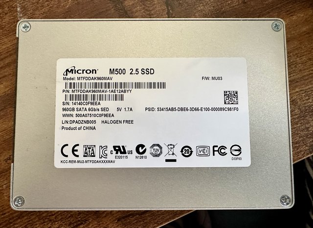

So fortunate to have received a belated birthday gift today from Robert - a 960GB Micron M500 2.5 SSD from his stash of used drives! He included an enclosure as well. Here’s what I am wondering:
- From what I understand, this Micron M500 2.5 SSD IS compatible with my late 2012 mini and I can use it to replace the bad drive in my mini BUT I have a Fusion Drive (1TB spinner HDD + 128GB SSD) so can I swap out the 1TB spinner HDD for this MIcron SSD while keeping the 128GB SSD part of the Fusion Drive in the mini?
- When I watched OWC's hard drive replacement video for the mini, they were only replacing one drive - meaning the mini they were using didn't have a Fusion Drive- so do I need to find a video that shows how to swap out the spinner drive while keeping the 128GB SSD part of the Fusion Drive or is it all the same procedure or is there an extra step to keep the 128GB SSD in the mini when replacing the main drive?
If I keep the 128GB SSD in my mini and swap out the spinner with the 960GB MIcron SSD will they still work together as a Fusion Drive? Or should I remove the 128GB SSD all together?
EDIT: From what I’m told, the Fusion Drive in my late 2012 mini is ONE module - so when i swap the drives I’ll be removing the spinner HDD + 128GB SSD. So there shouldn’t be an extra step correct?
Thanks in advance!!!!

Re: RE: My mini resurrection update - questions
Posted by: ka jowct
Date: February 24, 2024 03:35PM
Just ditch the 128 GB drive and replace it.
There isn't much reason to complicate things with trying to make a Fusion drive, a solution that was just cheap BS on Apple's part, IMHO.
Posted by: gadje
Date: February 24, 2024 03:54PM
Fusion is a combination of SSD and HD.
Just replace both with a single LARGER SSD.

gadje
Crap…the Fusion Drive is 1TB spinner + 128GB SSD and I only have this 960GB SSD…..am I doomed?
Posted by: Fritz
Date: February 24, 2024 04:00PM
Jerry®
.am I doomed?
not unless you had the previous (I assume at this point, dead) drive overstuffed.

Posted by: PeterW
Date: February 25, 2024 07:14AM
“ Don’t think meat - just throw”
Take he bottom plate off.
Remove the RAM
Undo the fans screws, pop the fan connector off the logic board and remove the fan.
Remove the screws holding the antenna plate and push it out of the way. (You don’t have to disconnect the antenna connector)
Remove the screw holding the plastic piece on the left hand side of the mini and set it aside.
The SATA connector is on the left hand side right where that shroud was. Pop it off the logic board.
That’s it. Put the things you removed back and close it up.
Put that new SSD in the enclosure it came with, plug it into the USB port and fire up the mini. Hold down the Option key with one of your thumb drive installers attached and go to town.
That all. Stop thinking about it and do it.
Good luck. We’re all counting on you.
Posted by: Robert M
Date: February 25, 2024 10:33AM
Jerry,
You're overthinking this. Installed internally, the SSD can reach 500-600 MB/s. In theory. Externally connected via USB 3, the SSD will be slower because of a bit more overhead. However, you're not talking numbers that you'll notice. For your purposes, it won't matter.
It's less question of which will give you better performance and more of versatility and future usability. If you install the SSD internally, you'll save some desktop space. However, when the mini dies or it's time to replace it, you'll be getting rid of a perfectly good SSD with it unnecessarily. That's a shame. If it was my mini and it's a 1TB SSD, I'd be pulling the drive out and dropping it into a box before I got rid of it.
If the SSD is in a case and you're using it as an external boot drive, you get rid of the Mini and keep the drive for use with another machine.
I wouldn't say that if it was a 128GB or even a 256GB SSD. Not really worth saving them due to their low capacity and the fact that they are cheap. A 1TB SSD - even a 2.5" SATA model - is high capacity and can serve many purposes with a newer machine as an external device.
